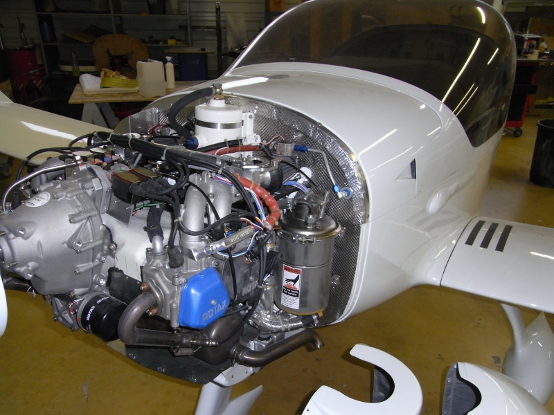

Here is the MCR 01 Aerobatic done by Dyn'Aero as requested by a customer.
You have several changes on the aircraft, but it's quite expensive.
On the engine, a Rotax 912S, you have an injection kit
You can see more details on the topic De l'injection pour nos 912, but it's in french! You can see more photos anyway...
This system is working well until now.

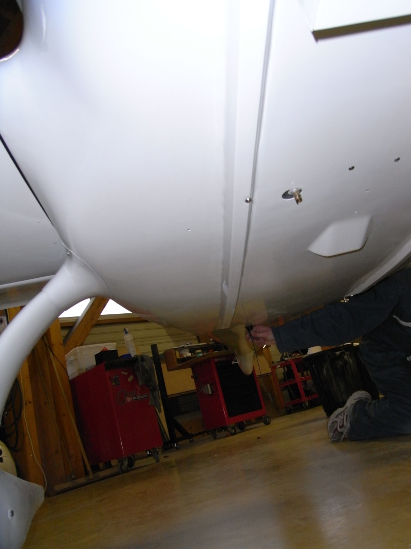

And some reinforcement below the fuselage (same as the MCR 4S).
advanced flighing (english) Rimg0218
